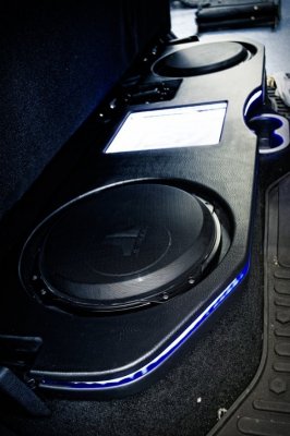

I'm thinking of getting a setup like this with 2 10W6v3.
That's a good setup with that, I have 2 10W6 subs in my 2013 Dodge Ram, bass worx makes a great box with just the right air space needed for them. And that's what I have in my truck along with 2 JL Audio Amps and 4 JL Audio 6x9 speakers, and running a pioneer 8000NEX head unit

W7 will not fit the magnet is to big and also needs more air space, use W6 or W3 there the best bet
