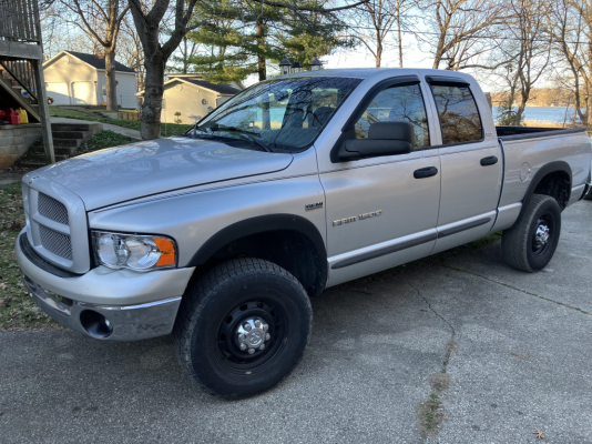

Just bought a 2002 Dodge ram 1500 with 8 lug wheels
Westcliffe01
Mar 19, 2024
15
Michigan
2002
5.9

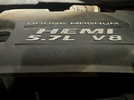

Hi folks. Im a recent buyer of an old 2002 Dodge ram 1500, quad cab. The bed appears to be 80" long. Its a 4wd model and the engine air intake says "Dodge Magnum Hemi 5.7L V8".
Front and rear axles have 8 lug wheels. Stickers on the bodywork say SLT and Hemi. Mopar decoder says 45RFE transmission.
If I run the VIN on mopar decoder it comes up as a 2002 DODGE RAM 1500 QUAD CAB PICKUP but it says a 4.7L V8 not a 5.7 Is there any part of the vin which may clarify the 8 lug wheels/hubs ?
How would I get the correct parts to rebuild the front left and right axle shafts ? I may also need to replace wheel bearings on both front hubs. Most of what is out there for the 1500 trucks have the 5 lug hubs and wheels. Was there a special HD version of the truck that got the 8 lug wheels and hubs ?

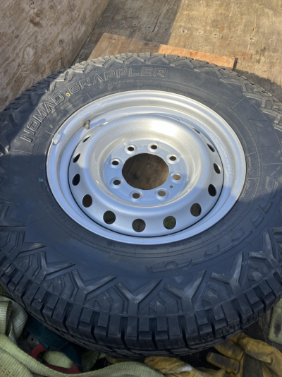

Yes, definitely 8 lug. The spare was missing so I had to buy the 8 lug rim and a matching tire.

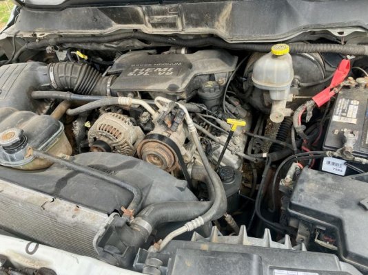

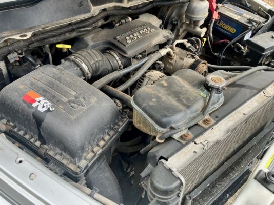

Pull the engine cover off, and show us a picture of the engine
W
Westcliffe01
Mar 19, 2024
15
Michigan
2002
5.9
There is no engine cover. The only plastic is the air box over the air intake.
I will get a proper wide angle shot tomorrow when the sun is out.
