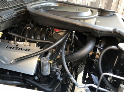

Many of us dump it when we go eFan. Look how much more room in the engine bay without it. No higher engine temps here. (Disclaimer: I did have a 180 Tstat problem, but I resolved it).
