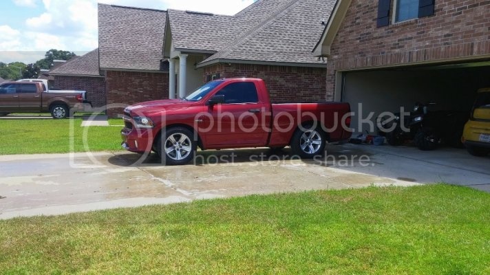

I just recently bought some used Sport wheels. From far away they are great.
But up close...
Any tips on the correct process to eliminate the scratches and shining it up a little? I don't want them to be mirror shiny, but just a little more than they are now.
