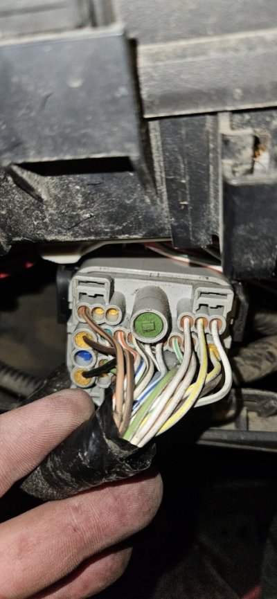

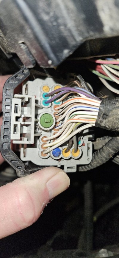

Was attempting this tonight on my 2015 Ram 1500 Express (afaik - bought used...)
I programmed the vehicle via AlfaOBD and I believe that all took. When I hit the remote start on my keyfob the dashboard light up as well as the lights on the panel shifter, but does not start - nor throw any on-screen errors indicating the hood is open. Based on the video from BlueRam (linked previously) I may not have the proper wiring going back to the BCM.

jawzs2
Air Force
Mar 24, 2014
2,925
5,465
South Jersey
2010, 2014
1500, 3500
A lot of reading - but this thread has all the info you need,
@Mpgrimm2 might be able make the harness you need if you don't want to try and tackle it yourself
You can ground out the PIN at the BCM to get it working. Did you do this or just turn it on? If you want the complete upgrade, @Mpgrimm2 is definitely your huckleberry.
If you're talking about installing a resistor on the BCM itself or (as I saw someone else mention) wiring to ground against the parking break, I did not. I think I want to at least try one of those first to know for sure everything else is working before spending any more on the harness. I'll read through the entirety of the other threads; I think I saw a post that had a pic of the BCM
Fair enough, I took that same route. @Mpgrimm2 should be able to tell you what you need from those pics you provided (I can't remember myself).

Mpgrimm2
Supporting Vendor Navy Badge
Mar 30, 2014
6,586
5,199
SC
2022 Ram 1500 (5th Gen)
5.7L
You will also need to check and see if you have the violet/ striped wiring from the hood latch to the front-end connector under the PDC at pins 5 & 6 on 1500 (1 & 2 for 2500/3500) on both sides... Could be missing from the latch to the PDC and/or from PDC to BCM. There are numbers next to terminals at the back of the connector if you look closely.
(It looks like you're missing wiring on 5&6 on one side (I can't tell male vs female terminal side in your pics).
Note:
There are 2 different hood latch part numbers (1500 vs 2500) with different resistance values/settings needed in AlfaObd. both are physically interchangeable. Here's what I usually share with people to do using the following hood latch and full wiring back to BCM pin 11 and one side to ground (after going through hood latch assembly).
* WARNING *
It is not safe to simply ground the BCM pin 11 input without going through hood latch!
1) the engine could start without warning while working on/near it with hood open.
2) I personally do not like the idea of grounding out a digital input to any controller that I don't know the internal specs of .... especially without using some sort of inline current limiting resistor to avoid damage. It may be fine if the engineers added one internally at the BCM but I do not know. It may be fine for awhile and fail at a later point... up to you.
