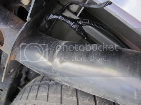

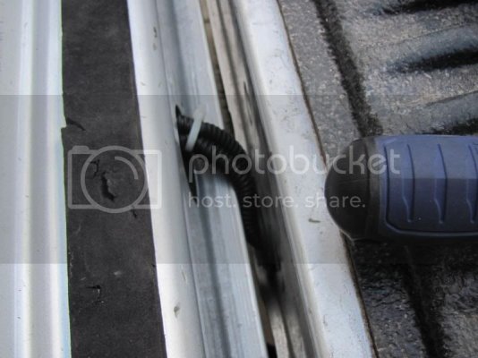

Started by pulling back the carpet under the passenger side rear seat and drilling a hole through a plastic grommet in the floor and feeding the cable through. I put some flex loom over the wire and ran it through the frame to the rear of the truck. Glad i had a fish tape lying around the garage.IMG_0588.jpgIMG_0591.jpg

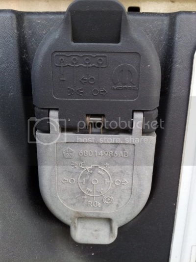

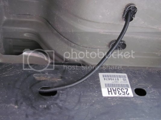

Spliced the power and ground wire into the trailer plug wiring and ran that to the grommet going through the bed of the truck. Hooked the positive to the reverse wire and the ground to the ground wire.IMG_0602.jpgIMG_0592.jpgIMG_0593.jpg

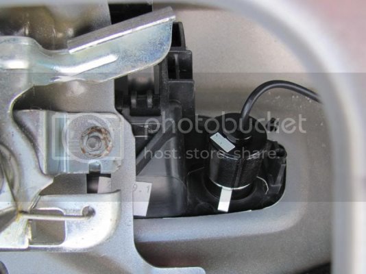

I drilled a hole through the tailgate handle in the factory location just big enough for the camera to fit in. This camera fits great and looks factory.IMG_0589.jpgIMG_0590.jpgIMG_0595.jpgIMG_0594.jpg

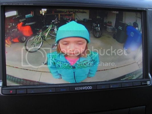

Zip tied the wires out of the way and finished up with the adjusting of the camera to make sure the picture was straight.IMG_0598.jpgIMG_0599.jpg

What size hole did you drill for the lock in the tailgate?

it says to make a 15/16 hole for the camera. I just kept making the hole bigger till the camera fit. I didn't have a big enough drill bit but managed to make it work with a little patience and a steady hand. I used a Irwin unibit to make the hole.

I do not remember the colors off hand. I used the trailer plug on my truck and it has a diagram like the one below on it. I just spliced into the corresponding wires. The middle wire was the positive reverse wire and the one below that to the left is the negative. You can also ground the camera to some bare metal in the tailgate instead of running the negative wire.
