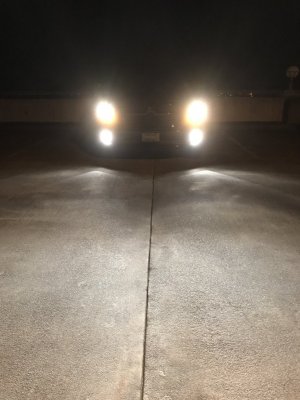

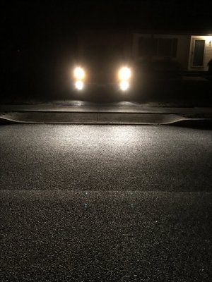

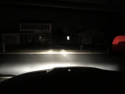

49EEC827-C5DF-438E-A38A-32E71DCBD2D3.jpeg 184EA1A8-AF3A-4007-96A2-6A5354D5E4CD.jpeg 4C66E5D8-08EB-4192-B408-0FE7AEE057CE.jpeg EE113B81-2660-47E1-BD63-37A7940C75B8.jpeg Hey guys I know everyone has their opinion with lighting options but I just want to say the quick bulb swap on my 15” ram express with projectors was a huge difference I needed asap. I tinted my whole windshield 35% and the stock lights are terrible even before the tint. I figured I’d get better bulbs for now to get me by and order hid kits. First night with the zxe and I’m not even going to bother gettings hids. 9012 heads and 9006 fogs, autozone shipped to house next day with their coupon it came out to 103.00. So if anyone is on the fence I think you won’t be disappointed. I did the job also in 5 min.

Yea I totally agree with you on the angle that I didn’t want to deal with that crap either with the hids...... I will keep the philips in mind if one of these burn out and I gotta get a new set but I’m pretty happy with it now...... I actually see the road a whole lot better with my windshield being tinted and these new bulbs then before the tint and the oem lights lol

Let me clear that up slightly with the time it took..... 2 fogs were changed in less than 30 seconds lol and each light took about 5 minutes.... pull the little wheel well hatch to release the headlight retainer ..... 1 10mm bolt comes off with a wrench the other 10mm bolt down by the grill I took out with 2 extensions hooked up to a 3/8s wrench ..... change bulb and repeat ..... little trick putting that bolt back in get some electrical tape cover ur socket hole and press the bolt in the socket so it holds it as you bring it down to the mount to tighten it up. No grill removal needed ..... if you ever have a question cause your attempting to do this just message me and I’ll walk you through it
