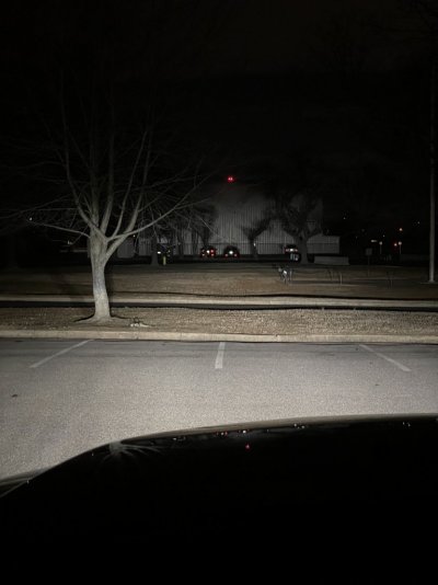

Got my bulbs in last night and after going on a test drive, they work pretty good. At first I thought they might not quite be bright enough but I could definitely tell they're in there when the brights are turned on and only once or twice did they turn off from the reflections so Ill just have to live with it. At least I can run at night without having to run my fog lights so I was able to put my yellow fog bulbs back in for when I actually need them for foggy conditions.

Super satisfied with these for my highs. Auto high beams work fine. The occasional road sign may trip them but the rest are fine.

View attachment 513289View attachment 513290
Your link’s not working.
But yeah, I’m pretty satisfied with those 9005s I got from SparkSmith. They could stand to be a little bit brighter but like with yours, these will cause some road signs to make my auto highbeams turn off when they’re not supposed to. All in all, I’m pretty happy with them. I just hope they last but they do have a five year warranty.

Nice, same here, I fixed the link. Thanks
