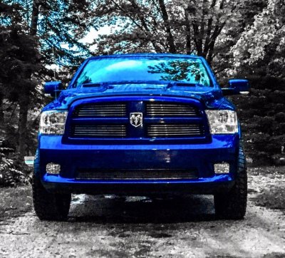

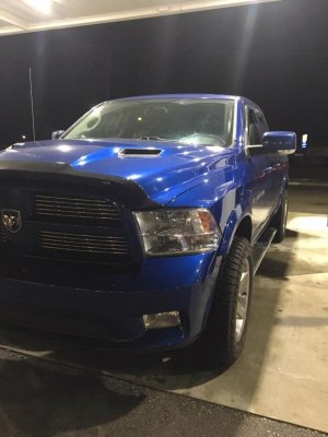

I debated on what size wheel spacers to get for awhile until a buddy of mine picked up a set of 2" ones and after seeing them in person I decided thats what I wanted also. I got the supreme suspensions spacers (walmart. com has them cheaper than amazon by $30 btw) they are excellent quality also.
I just figured I would share some pictures of it for those of you out there that like me searched and searched for a set up similar to mine to get an idea of what things could look like.
A little break down, 11 ram 1500 sport 4x4, bils set at 2.1",zone diff drop, Falken AT3's 275/60-20 oem size. Oem sport wheels. I body matched and installed flares and I wanted the tires to not look so tucked in on the truck and these spacers were exactly what I was looking for, Just enough poking out for a bit of a bull dog stance but without looking silly in my opinion. I also just installed Dorman 611-204 lugnuts btw and got rid of the crap oem tin caps and I recommend everyone do the same. They are solid and stainless!.

The flares I got about a year ago on amazon they are oem style 2500 flares (the flares don’t go all the way down the front bumper like a 1500 flares and I thought the 2500 flare looked better with my sport bumper). And I’ve got to say I was amazed with the quality and the fitment Of then!, I was skeptical I was going to get I’ll fitting aftermarket parts but they fit as close to factory as a friends actual factory ones and were indistinguishable from one another . Here is the link to them.

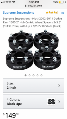

The spacers are on amazon and a few other places but I got them through Walmart’s website and they are on roll back and you save around $30!. They are amazing quality!, hub centric and t6 aircraft billet . Keep in mind that 09-11 use a different wheel stud so if you are looking for 12+ make sure you check for the current spacer part number,I think the thread pitch on those is 114.5mm or something like that where mine (09-11) is 9-16x18 . Here is a link to the ones I bought. https://www.walmart.com/ip/Supreme-...ts-the-2002-2011-Dodge-Ram-Set-of-4/224751515
