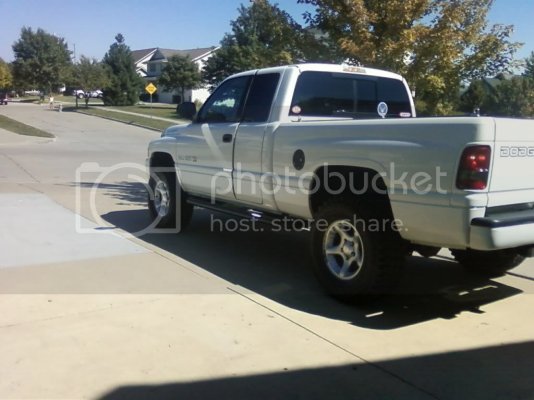

Yeah that lift should be good. Here is a stock off road (which is roughly about 2 inches higher than a regular ram) with 35s on 17s rubs at full lock

That looks good
