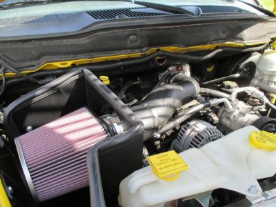

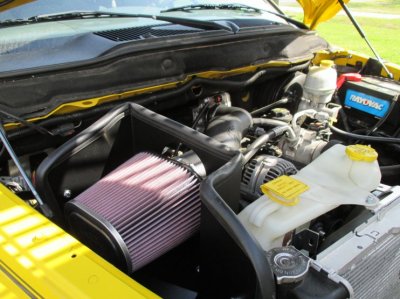

To get the best performance I went with the K&N 57 series CAI and I like it. It isn't loud until you put the pedal to the floor, then you can hear it pulling in a lot of air. The only deviation I made was to the breather hose, instead of connecting it to the breather tube, I installed a separate small breather filter in the hose, and wire tied it to my A/C hose.

I did it to my truck because my PCV system is internal so I can't justify a catch can. Instead I took the breather hose, that connects normally to the CAI inlet tube, and installed a separate washable air filter in the end of the hose. Now fresh air can be drawn into the oil filler and circulated thru the PCV system. This way I don't have the CAI inlet tube pulling oily air into the inlet tube when the throttle body valve opens. Now I do not have to worry about oily air dirtying my throttle body.:peace::waytogo:
