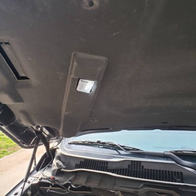

Also installed a under hood light, replacing the OEM bulb with an LED.
