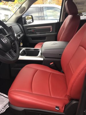

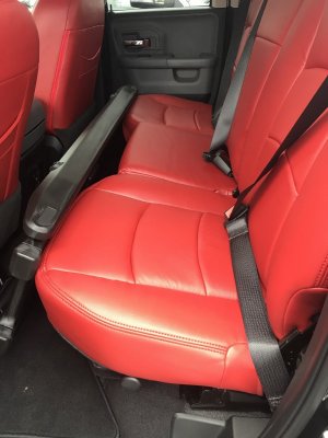

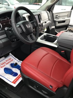

Had my Katzkins installed in my Lone Star before I took delivery. So far I’m very impressed with them.

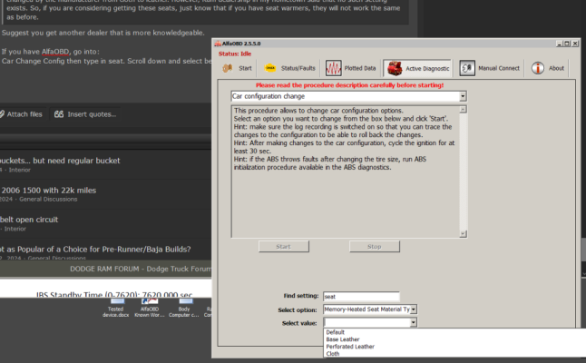

Got some seats installed back in April in my 2017 Ram 1500 Big Horn. They look amazing. The inside of my truck now feels more "luxury" than before when I had cloth. My only complaint would be the decreased effectiveness of the seat warmers. I can barely feel them now unfortunately. Customer service for Katzkin told me that there is a seat setting that can be changed by the manufacturer from cloth to leather. However, Ram dealership in my hometown said that no such setting exists. So, if you are considering getting these seats, just know that if you have seat warmers, they will not work the same as before.

Suggest you get another dealer that is more knowledgeable.
If you have AlfaOBD, go into:
Car Change Config then type in seat. Scroll down and select between base leather / perforated leather or cloth

You aren't wrong about finding another dealer! But this helps. What is AlphaOBD? Is this something that i could do myself?

AlphaOBD is a software package that allows you to turn on different options. For example I bought fog lights and installed with a factory switch. I used AlphaOBD to turn on there ability for my switch to turn the lights on and off and also changed the setting to allow them to stay on with high beam. You need the software, a dongle that you send the settings into your truck from your phone or computer, and for 2018 up a security bypass cable.
Read through this for ideas. https://www.ramforum.com/threads/alfaobd.123982/
If you do get it, BACKUP YOUR SETTINGS first.
Added the link I meant to add.
