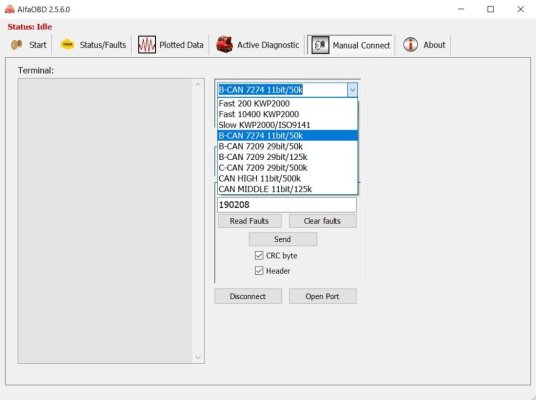

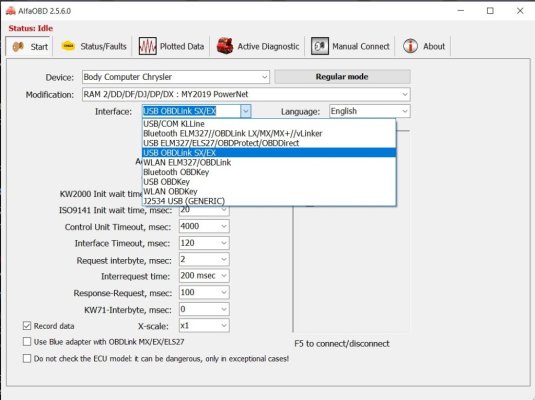

My mistake about the Manual Connection options in AlfaOBD.
It allows a terminal function for reading/clearing faults, sending commands, and adjusting the OBD protocol format used.
The AlfaOBD Advanced Mode allows a manual selection of the interface type.
I have no experience tweaking these settings.

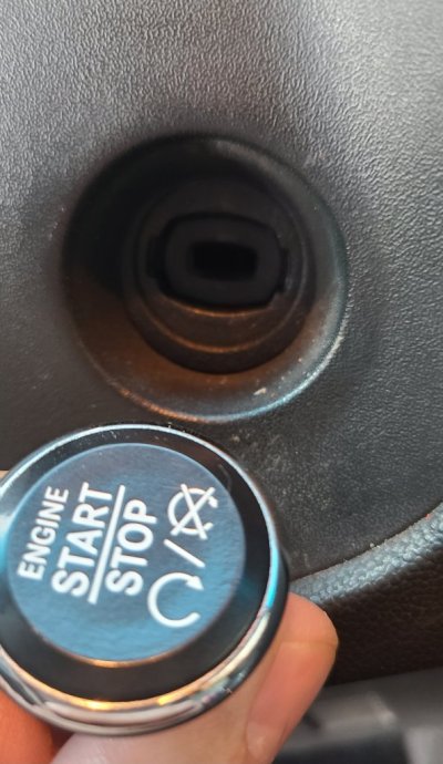

To program a new fob with alfaobd you usually have to have an existing fob in the on position to start the procedure. I'm not sure it will work in your situation. You can try, but may need a dealer to do it.
Also, with the push to start feature in a 2014, you can remove the push button to expose the keyhole below it. The new fob can be inserted and switch to On.

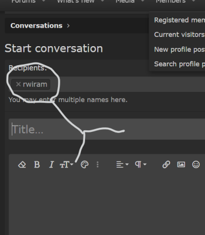

Sorry but I can't seem to figure out how to PM here but interested in reclaiming my WIN 7 Pro setup......Thanks RW
