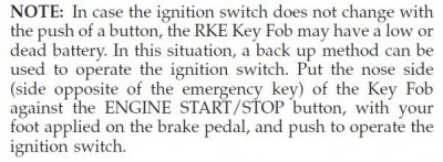

Hello guys,
Some people are asking about this so although it's in the manual it's worth saying:
The easy way to get you going if you are stuck with "key fob not detected" and you have no spare fob or battery with you.
Firstly get inside your truck using the physical key hidden inside your fob, then simply press the start button with the black end of the fob itself. With or without the battery it works and at least you can get home.

Yup...just like it tells you in the owners manual.
