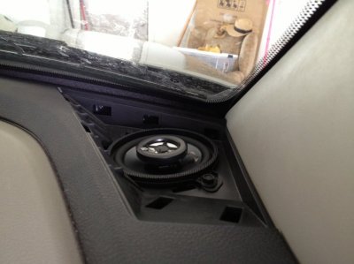

Well, being that everything in my system was aftermarket except for the dash speakers, I figured it was about time for an upgrade. I purchased the Kicker's from Sonic Electronix for $50 shipped and the wiring harnesses from Crutchfield for $10 shipped. I wasn't expecting much of a difference in audio, but i figured $60 wasn't too bad of a price for curiousity. After removing the speaker covers (pry them up with your fingernail or a flathead), two 7mm bolts hold the stockers in place. Getting the bolts out is the most difficult part of the install, as it is hard to get a ratchet into the small space between the speaker and windshield. Upon removal of the bolts, the stockers just lift out to reveal the wiring harnesses. There is a small tab that sticks out on one side of the harnesses. Push it in and the harness slides away from the speaker. Plug the corresponding ends of the harness into the stock wiring and new speaker and place the Kicker into position. Replace the 7mm bolts and speaker cover, repeat for the opposite side of the truck and you are good to go. I left one side Kicker and one side stocker and switched the audio from left to right and was amazed at the night and day difference. The Kicker's are much brighter and bring the music to life.
