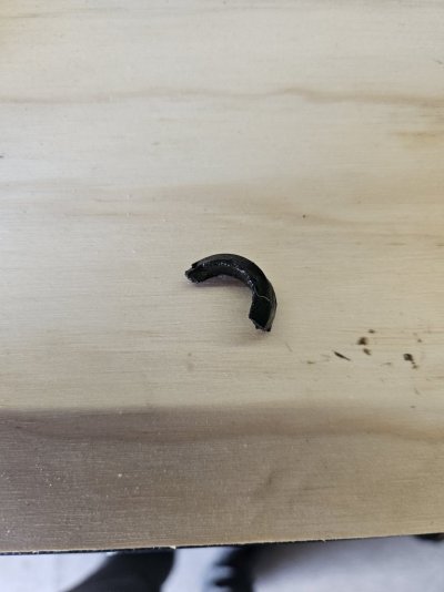

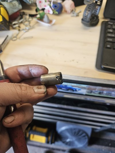

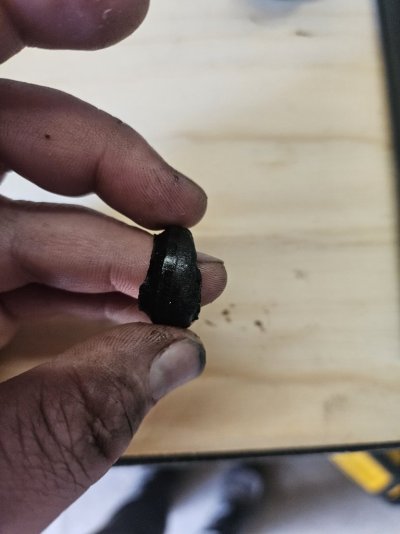

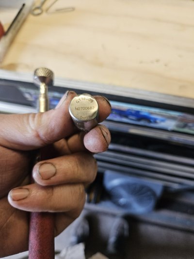

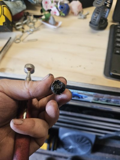

Dropped the oil pan today to check the connecting rod bearings.
I found this in the oil pan.
Anyone have a clue on what it could be?
Also I found no play in the connecting rod/crank shaft bearings.

I still have no idea where the piece of plastic I found sitting in the oil pan came from.
looks like the partial end of a old cam or crank sensor to me.

Yep its a old crankshaft position sensor its very common for them to snap off into the block your noise still sounds top end to me.
