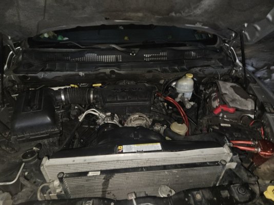

I need some help identifying where this knocking might be coming from.
I have been smelling exhaust in side the cab in start up as if it's an exhaust manifold leak, but this started while towing an empty trailer yesterday.

The knocking gets faster and slightly louder under acceleration and goes quiet when coasting or stopping and is quiet and steady when idling.

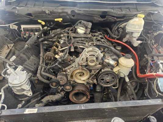

So after replacing the lifters, rocker arms, timing chain, exhaust manifolds and studs. And the noise not stopping, tomorrow I will be dropping the oil pan and checking the connecting rod bearings.
