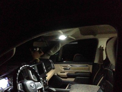

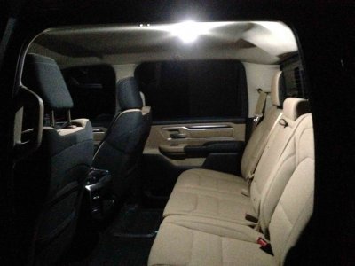

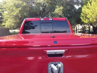

YUP, on MY 19 Bighorn with non BSG Level 2 Optional Equipment. BTW, all Interior were incandescent also. I changed all them out, but was hating LIFE with that PITA upper console. The only thing I left reg bulb was glove box (lower). Upper box LED plate. I could do the CHMSL but with all the leak issues, just gonna leave a lone, not wanna tempt fate. And I have a full solid tonneau ne way.....
NOTE: NE BODY that goes to play with upper console on MY 19, beware, there are (2)_ hidden plastic tabs also into the head;liner that are located near the screws in the glasses holder but a lil towards rear of truck. I did not know they were there, and BROKE them both off, Beware, LOL...
