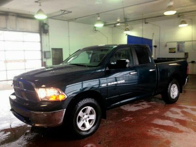

Yep, It has 1
35's is about the most you can stuff under there. You going with a aftermarket wheel or staying with stock? If stock you will need a 1/4in spacer and anything with a negative offset you'll be fine with no spacer.
315/70 17=34.4x12.7
XD Spy with -12 offset
No rubbing

Yep, It has 1
^^^^crappy pic
Sorry here's another

^^^^crappy pic
That looks perfect
