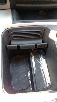

I was with a colleague yesterday and I noticed this update and snapped a pick. I was going to start a question thread about it, and then I seen this one started. This is from a 2015 CC Hemi Lonestar edition 2wd. He said he purchased the truck off the lot early October.
Chumba - I don't know about losing the 12v doing the swap, this one has it. It is under the holder.

I just finished doing the swap and everything fits perfect! You will not lose the 12v plug that is in the original console trim/bezel pieces .. I will post of some parts number tomorrow. You have to by 2 separate parts. One is the larger part of the console, the second one is a mat, that goes in the cubby underneath the switches for the heated seats ..

Here are the part numbers for the mid year console update/change:
Mat - 5VC95DX9AC - $11.00
Bezel - 5VC931Z0AA - $203.00
