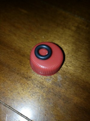

Nah, I'm a mechanic myself (jet engine). Shops here in south Florida are shady to say the least. I already fixed the issue I just wanted dodge to step up to the plate. Defective O-ring on my fuel injector causing it to **** fuel out on my manifold. Thanks Dodge for pinching it on install and thanks for nothing regarding any assistance.

You say you bought it used,there could be the chance somebody prior to you had the fuel rails off the engine,and pinched the O-ring on re-install,might not be a factory defect if that was the case.

I’m willing to bet someone had it apart at sometime, and possibly damaged it during installation. If it was a factory defect or installation error at the factory it would not have taken 63,000miles to occur.
Fuel injectors are also only covered under basic warranty, so you’re long past that unfortunately.
