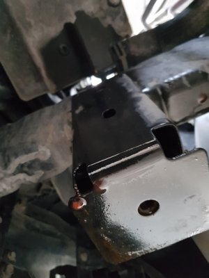

Been smelling what i thought was leaking coolant for a bit, snow finally melted and dried from my driveway and today after driving i discovered red fluid pooling on the ground.
There is no fluid on any of the hoses just seems to be leaking from the bottom passenger side of the trans oil cooler ...
Can i fix the inlet or am i sucking it up and buying a new cooler condenser ? Im shy of 60k miles so should be in warranty but not sure this is covered...

As it turns out, the coolant on this truck is red.. something about 2013+ OAT coolant. Engine bay side of the rad is covered, seam leak on the pass side.
