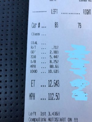

Dyno numbers are only for the naïve,what do these trucks run in the 1/4 and at what DA. Case in point my buddy has a healthy bolt-on 6.4 Superbee that's got a dyno sheet showing 510 rwhp and 505 rwtq ,but my 435 rwhp and 455 rwtq truck that out weighes his Superbee by 600lbs outruns his Bee by 3/10's ,like I said dyno numbers are only for the naïve. A dyno is a tuning tool,nothing more/nothing less. So what do both of these trucks run at the track?

Dyno #s are only given as example of what each direction will give him. a good combo 5.7 in these trucks is hard to beat with out spending lots of cash.
Jan 17, 2016
23,632
54,260
14 Sport
Not bad numbers,but nothing to write home about,lol. I run 12.21 at 4,000ft DA with 435rwhp in a 4X4 no less. Your new combo better put you in the mid 11's,or else I wouldn't be bragging to much about your horsepower and torque numbers,lol. Hate to say anything but you won't make the top 15 list on Nadodge,i'm one of 2 4X4's on the list and my 12.21 puts me at 14th spot,lol.
Gary's Hemi on here has run a best of 12.5 with basically a stock truck,cold air/afe midpipe and that's about it as far as mods on Gary's 2015 R/T. Kyle Tingle has run 11.98 with a bolt-on truck,with a cam and small convertor. 12.6's are decent numbers,but not really fast enough to be bragging about your dyno numbers
