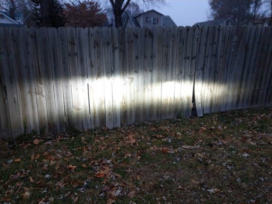

OPT7 (left) Hikari Ultra (right)
The Ultra has much less scatter and allows you to adjust the bulb alignment after it is seated and sealed in the housing. I would say it's about the same brightness but far less scattering of light.

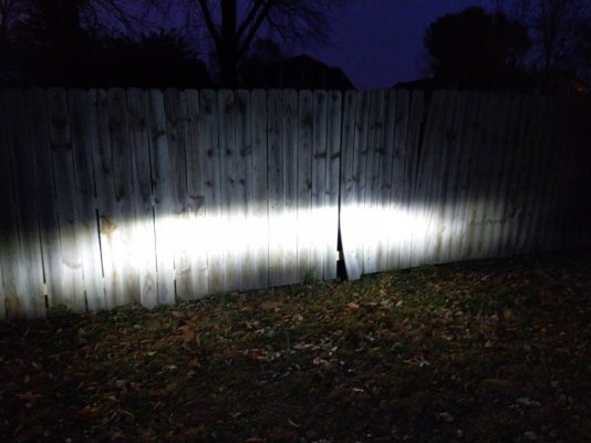

Hikari cheaper (left) Hikari Ultra (right)
Only slightly dimmer using the Mark I Eyeball (I had to stare for a while to see the difference in output). Honestly if I wasn't planning on using the cheaper ones on my wife's fog lights I would have kept that in my truck for the cost to brightness ratio. The Hikari bulb's alignment adjustment really focuses the light in our quad reflectors as well.

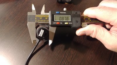

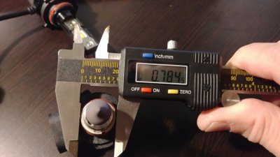

So I got my order yesterday. Just went out to put the 9006 fog bulbs in ....and they don't fit? I've tried other 9006's and they fit fine but the outside diameter of the collar of the light (where the rubber gasket is) is too large to fit in the hole for the bulb?
Anyone else try theirs yet?
Mine looks good, I'll try it out now and see...42b234d511bdca923fa0af2a1ac2d703.jpg

Interesting? Maybe it's the wrong bulb in the right box?
Have you tried to fit yours yet? It's hard to tell by just looking at them, it's not off by much but it's enough where it won't fit in mine.
There is no marking on the lights themselves so can't tell if they are they right part number or not. The box is correct.
Mine fit just fine too. Here is a close-up of the other set I bought for my father in law. It should be marked right in the base...a53e37ee1fda5c964c5a74e1dc359995.jpg
