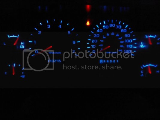

got the roscolux in the mail today! just got it finished up now, gotta go put it in the truck and see how it turned out... already did the overhead earlier.
this pic doesnt really do any justice, looks much better in person.

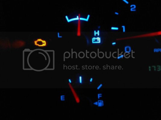

anyone know how to maybe "blend" the color any better towards the bottom? i believe somewhere i read something about wax paper in the climate control???
its brighter at the bottom than the top.

everythings done now on the dash! just gotta figure out how to blend the hot spots somehow. any ideas? i heard someone say something about wax paper but not sure how to do that :hmm: any ideas?
