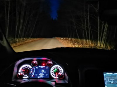

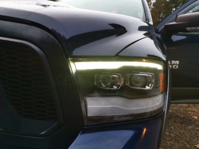

Spend $300 and get the Modifystreet headlights. Complete housing replacement. Direct swap. The output is so much better as to not even be comparable.
Every other bulb replacement for the quads will only get you more brightness in the crappy beam pattern, or even worse....many give even less output than stock due to giving an even worse beam pattern, and/or glare.
Do yourself a favor and lookup the thread from the last few weeks regarding Modifystreet...
I got mine in a couple weeks ago after doing the H9, the LEDs (multiple sets) and HIDs (good brands)...I am a stickler for lots of light and good beam pattern. These are the real deal.

It comes with new halogen H7 and you can choose to upgrade to HIDs as well.
I chose the HID, but others have gone with halogen....both are awesome. Check out the pics in that thread.
