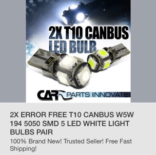

So would these work? I'm a little confused on the right part #s to get. The stock bulb from the liscense plate is a 194 I believe. Are the dome lights the same bulbs? As for the reverse I think I'll go with the retro solutions bulbs unless I can find another one that's clocked the right way.

Oops forgot the pic.

Yeah, no problems so far. I've read of others having issues and others not, very strange.
As far as the dome light. I have the one in the center rear, that bulb is a 212-2 also known as a 4410. if you have a different configuration, I am sure someone else can chime in with the bulb numbers.

I have a 2014 Express, you WON'T get an error for the tag, reverse, third brake or interior lights. I replaced them all with fleabay cheap led bulbs and get no warnings whatsoever.
You will get them with the turn signals, you would need resistors for those.
This. Same here on my 2013 Express.

Weird. I have a 2014 lonestar and I got a license plate out warning the first time I started the truck. Now, I get the message about every 3 weeks. I guess it has just enough current draw to not give the error message. I did get it every time on the 3rd brake light, though. There are no messages for the interior lights and I don't get it for the cargo lights either. I have 194 led's off of Amazon.com and the festoon type led in the dome light. All just regular led's.
