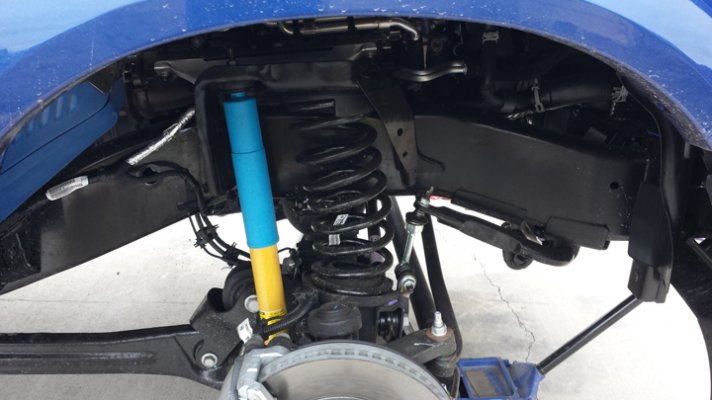

We'll that's not true.
That's what the guy at Carli told me. I'm assuming you're pic is of a 3" spring and if so do you have a full 3" of lift?
Who makes the spring? I sure don't see a bow in that spring.
What kind of set up do you have?

May not be bowed but it certainly isn't straight. Either way I think you'll be fine, as I mentioned correct length shocks and adjustable track bar are key here. A slightly bowed or non straight spring are the least of your worry.

I hate to be the bearer of bad news but non of the radius arm trucks have straight coils, factory or aftermarket. You're looking at a setup up with correct toe-in and caster and nearly perfect coils. The coil buckets always have angle to them, with or without radius arm drops.
Quick call RAM and tell them their OE coils aren't straight.
Full Thuren kit, 2.5" Kings, Boogies, front and rear track bar.
Thuren 3" Hemi coils will give you slightly more than 3" of lift.
As I said it's a non issue. A slightly bowed or not perfectly straight coil isn't going to cause major issues cause of the radius when the axle flexes.
