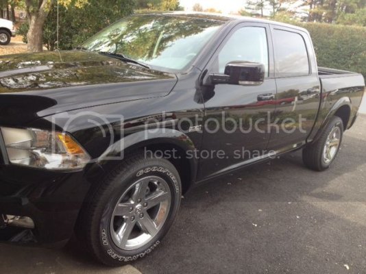

I just joined but read lots of threads before doing my Ram. I will try to upload some pics I took. I used the Rough Country 2.5 in front, 1.3/4 rear and put Nitto Trail Grappler 295/60/20 and it came out very nice I think.

Picture doesn' do it justice but it will give you a general idea...

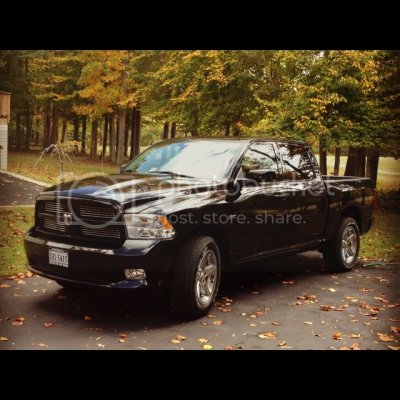

I can toss up some pics of a rc 2.5/1.75 combo tomorrow. I ran with just the front spacer for a few days then decided to toss on the rear spacer for kicks just to see. I much prefer the slight rake and look with the rear spacer installed. Also, no spring compressor needed. Easy install, did it by myself in my tiny 1 car garage with jack stands and hand tools. If I had to do it all over again I'd probably do bilsteins up front and the 1.75 rear spacer.

It was dark and cloudy here today so this is the best I could do:
sent via tapatalk
