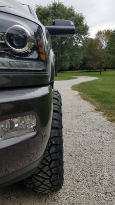

Finally got it sitting the way I wanted. 2" Bilstein level with 295/65/20 Nitto Ridge Grapplers on 20" Fuel Vapors with double dark tint. Tires are at 50 psi all around and ride is much better.

I'm running 46 front and rear on 295-60-20 Nitto G2's. Good tire wear and rides well.
