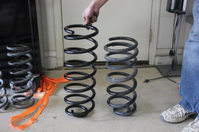

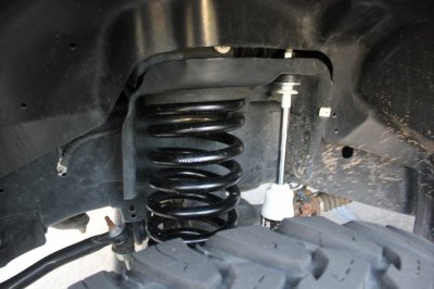

Fair enough, look at the pic I posted of the coils with spacers. If you do go with a spacer, keep it to 2" max
