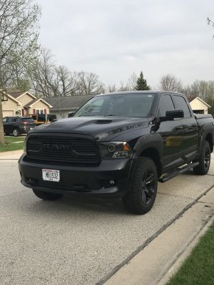

the entire setup being mentioned by GIJoe is what I have in my picture i posted above
