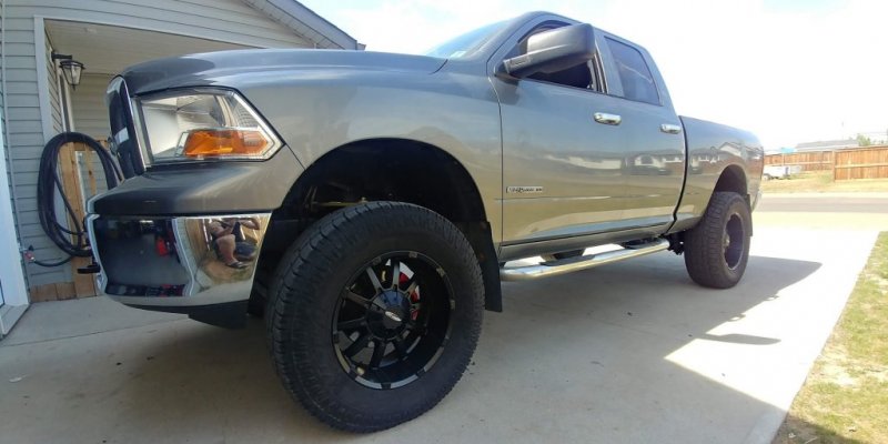

The 4" Superlift is an actual lift and uses factory UCA. My UCA are perfectly level with that lift and Bills 6112s set at 0.8.
