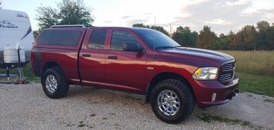

I have 18x9 -12mm offset with 35x12.50x18 General Grabber X3s with no rubbing.
I have Bils set ay 2.8 on the front.
