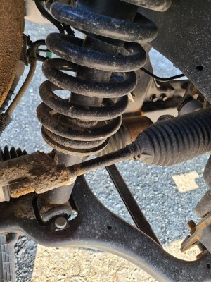

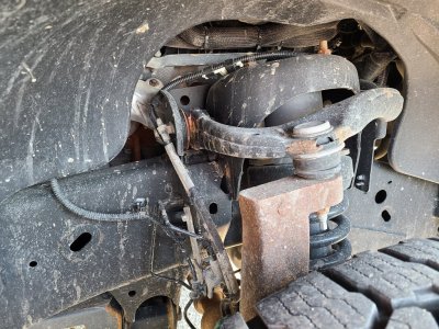

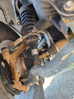

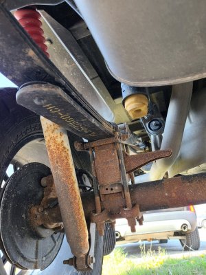

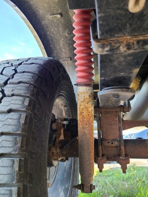

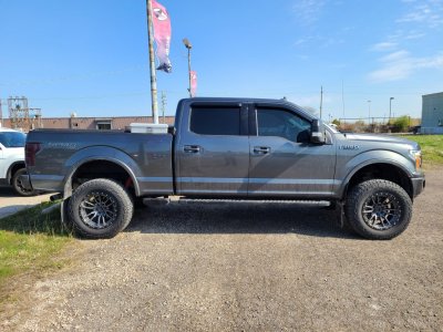

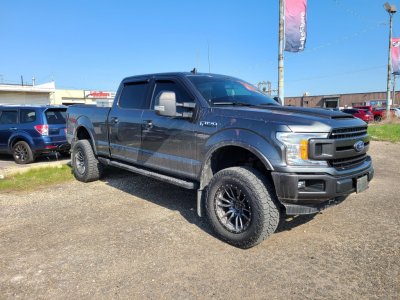

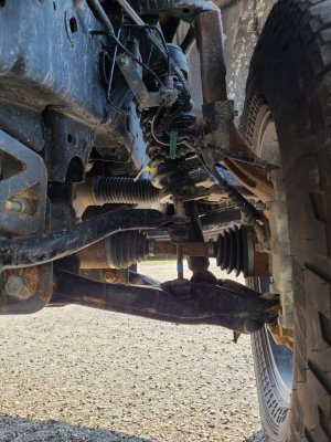

Can anyone give me any feedback on the lift I took some pics of on this f150. From what I was told it's a 6" trail master lift. I wasn't sure what pics and parts to get so I just took what I could.

I can get more or better pics or description if need be I just don't know what to ask or look for.
My concern is I know nothing about lifts and I'm interested in the truck. I don't know what to think about durability longevity of the lift or the parts around it.

I thought my Ram had alot of rust lol

Parts-wise it looks like pretty standard for a suspension spacer lift... cast steel knuckles, front diff drop, leaf spring blocks in back. They're not high performance (don't increase suspension performance over stock) but do provide elevation so if you're not going hard off road it'll be about as durable as stock with more ground clearance. I don't see anything wrong with it obvious in the photos, nothing looks like it's been neglected.
As a long time resident of the West any amount of rust terrifies me but none of that looks like cancer. Might want to address it now though if you wind up owning that truck so it doesn't progress.
Anyway looks like a cool enough truck, if everything else ticks all the boxes you need 'em to and the price works I don't think anything in that suspension would put me off from buying it.

Thank you I appreciate your reply.
As for the lift the guy does not go offroading but is a farmer and at work is all dirt and gravel. As for myself I will never go offroading so that's not a problem. I'm not buying the truck due to the lift wheels and tires it's for the configuration which is super hard to find right now.
