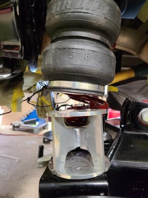

is it a 2500? i have a 5.5" zone with the same airbags. had a set of spacers custom made due to the angle it has. let me see if i can find a pic. hold please.......

No, its a 1500. I see people offer spacers like that. Will definitely need to go that route. Its just the potential of have to bolt multiple things to the same spot.

the one i sent pic of is not the custom one. that one didnt work. i dont have a pic of the one i had made but be careful when buying. may nit work like mine didnt

oh ok. gotchya. I went to the airlift website and they offer an angled lift bracket. Might stick with my Procomp lift choice and drill a couple holes in the lift block.
Yep, that would be what I would do. May not need to do anything other that drill a few holes in whatever piece comes with the lift. If that doesnt work, then you may need to buy a special spacer block.

I have a 6” and I’m going to be doing complete spring replacement in the rear to aid with picking up trailers without playing with a crank wheel. Air out rear, back under then air up. I plan to do almost what Chris did and fabricate some spacers. I’ll let you know how that works when I’m done. I take it your keeping spring and adding air to help hold ?
