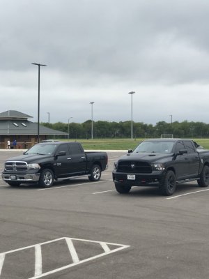

I had the standard factory that came with the sport edition of 2012 so the Icons were a quite a bit taller when the springs were pulled for the Icons. I don’t know if the springs were a bit compressed from towing because I purchased it a couple of years ago. The rear bumper is beat up pretty bad which indicates to me that the previous owner towed often.
This is how it sits now, it has a slight rake to it mine is on the right next to a stock suspension my neighbor has.
You have a DS truck. The coil springs length and specs are different between our DS trucks and the new DT trucks.
This is the 5th gen 1500 (DT) suspension section. If you lifted the rear of your 4th gen with Icon coils nobody in this section will get much from your post. In terms of coils that can fit, the Icons do fit the back of the DT trucks but we won't know the actual lift you can get from them until somebody with a DT tries them.
