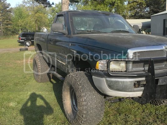

Photo bucket worked LOL but that is a pic of the truck b4 I got the new tires they look mean on it ill upload pics of that when I get a chance. About the divorced transfer case how much would I b looking at price wise on converting to that?

That's pics of the new tires looks good but rubbed a little I cut a little off my finders and it don't rub now but the truck drives a lot worse it really gets to road walking but that's expected with that size tire but that extra lift would help give me more clearance but ill just have to make due for now.
