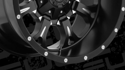

Anyone have an actual pic of these dual valve stem locations?
Looking at online pic I don’t see why that wouldn’t work

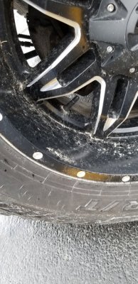

I have the Fuel Vapors, -44 offset on a 6" Procomp lift. See pic below. If I had the valve stem cap on the inner stem it would hit the tie rod. Been running these for about 6 months now and have not had a problem. Do you think if you removed the cap you might clear?

I have the Fuel Vapors, -44 offset on a 6" Procomp lift. See pics below. If I had the valve stem cap on the inner stem it would hit the tie rod. Been running these for about 6 months now and have not had a problem. Do you think if you removed the cap you might clear?
I just figured they would still hit so they moved them to the middle
Excuse my dirty rims lol
The second valve stem is on the back side of the wheel. Little piece of information left out by Fuel. It maybe a way for them to correct the TPMS not reading properly when mounted in its otherwise normal position. I am curious to know if the GM/Ford/Toyota ... truck owners have the same issue. Will take pics tomorrow and post.

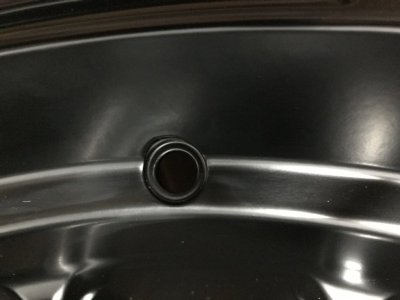

I just bought some Fuel wheels, they are still in the box, they only have one valve stem hole towards the outside of the wheel lip 20x10 -18mm
Looking at the pics, will TPMS work on these?

Thanks, I never considered it to be an issue until this thread popped up, just thought I would ask before I have these mounted. Mine only have that one hole on the outer lip, I’ve never seen a wheel with dual holes like they have.

Mine would hit my tie rod end when installed on the inner lip. You could see on the cap where it was taking the plastic off. As stated above you might get away with not using the cap but that is too close to comfort for me. The beating on the tie rod end tho ruined the sensors so had to get new ones before putting in inside location. Truck wont read them in that location tho so idk

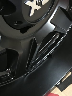

Wonder why it won’t read in the center location?
My XD wheels were close to the center and mine work fine (4.5 backspace)
