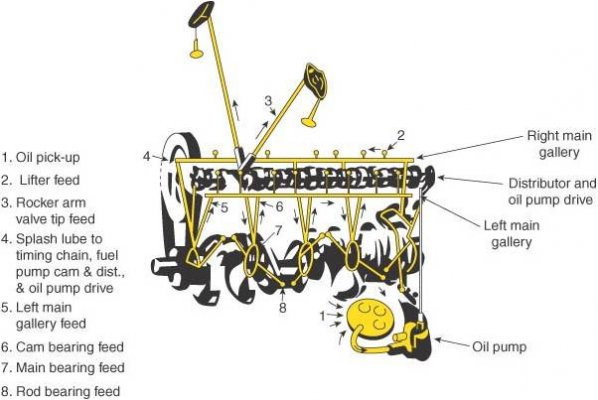

This is the 318, you should be able to drive the pump with a drill and see oil squirting into the lifter bore.

I didn't think the heads were part of the oil supply path. I thought the lifter bore supplied the oil from the pump to the lifter, which then pumped it up through the pushrod to the rockers and it was all just gravity from there back to the pan.
