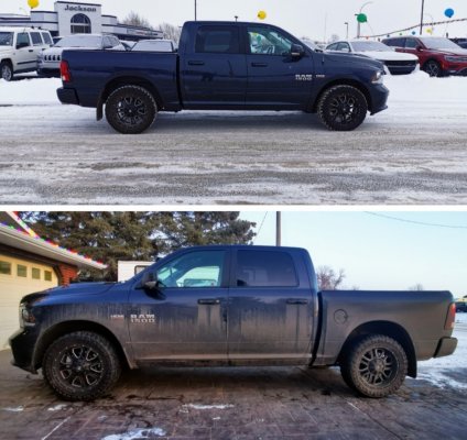

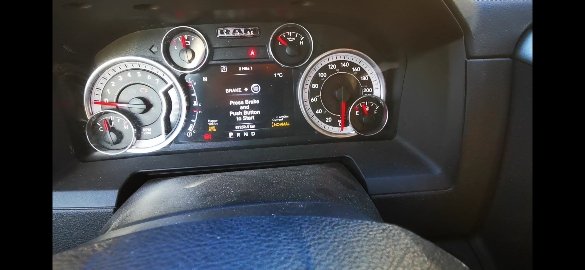

rtokamp
Dec 29, 2019
CA
I have a 4th gen sport that I just used Alfaobd to change the ride height settings to the Rebel and set it to an off road truck in the body control module which gave me the Rebel suspension options and says rebel on the dash screen when you start it.
stock was
Offroad 2
Offroad 1.
Normal/areo.
Entry/exit.
Rebel is
Offroad
Normal
Areo
Entry/Exit

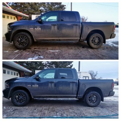

So now I can ride in offroad 1 up to 100km/h plus the truck is more level. I plan on messing with the height settings some more. You can see in the one pic that normal is now the third bar on the suspension
Edit: new picture of before and after messing with the height settings some more, a little higher and more level!!
