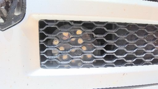

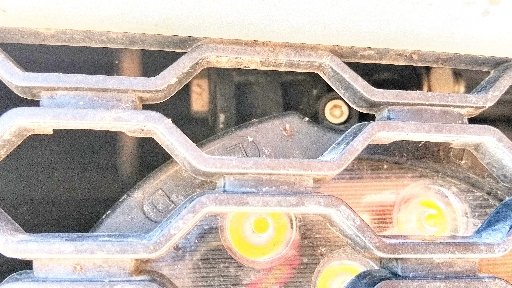

Not much room with the shutters.
Not much to bolt to. I ended up bolting to the plastic frame of the shutters. Im lazy to get up fir pics...maybe later
Sent from my moto g(6) using Tapatalk
misfit77
Nov 23, 2016
1,031
671
First thing to note, the grill acts like a collimator. Light only goes forward and output is reduced.
Here are pics of mine. Sorry, to get mounting pics i have remove the grill. Its 90 outside and it's too much work. So no mounting pics.
The lights i have are the slim 6"round u see on every 4wd site ir eBay.
I had to modify the exposure on my pics to see them. Look closely and you can see they are mounted from above, basically hanging from the plastic frame. Then the grill is smashing against them to hold them in place.2d39be804e168b592552fed39f9d8571.jpgc786202c8aee709345e0542aa59fb429.jpg69680184eec05128aa6515a367db35ad.jpge72fce39e3e7bb7dc88863c1965fe805.jpg

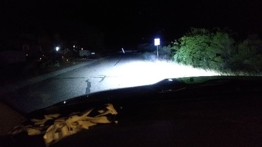

I’ve actually been looking at those same lights. Don’t suppose you have any output pics, at night, from inside the cab?

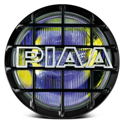

I personally have had such great luck with PIAA's, whenever I upgrade I like the yellow fog PIAA's. They are 50 state legal, and you do need to be careful on some of those lights that you can't use. The amount of light that comes from these are insane, better then any oem headlight, and the periphery views are amazing. Plus. of course when driving through fog, nothing better. These are the white ones, but I recommend the yellows. I can't say much about other after market lights, I'm sure there are great ones, and PIAA's aint cheap probably the better side of 300 bucks, but I swear you will not be disapointed.
Actually this is the one I bought on my last 4x4, not really yellow but a rainbow look, but the light is yellow and they are Fog rated.
I can try tonight

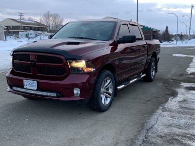

My 42” lightbar lights up excellent and I have LEDs in my fogs but I’m looking for more of a spotlight now to throw light past the reach of my 5D lens lightbar.

keep in mind the camera is sensitive on night shots. these look brighter that reality.
Here is just the rounds. Sadly I noticed 3 LED burnt out on the passenger side.
This is the rounds and headlights (Underground LED)
Rounds, Headlights and Nilites light bar.
