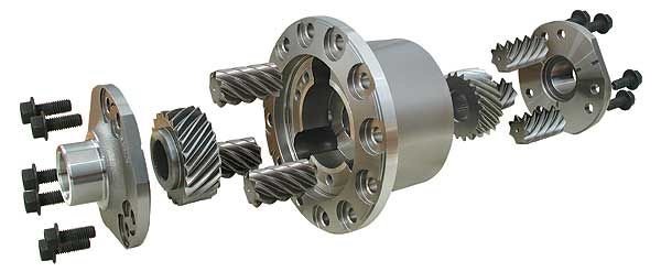

Go with a Torsten/Worm gear LSDb4bfa26fce1a34344e9794f15110216a.jpg that's what's in my 15' 2500.

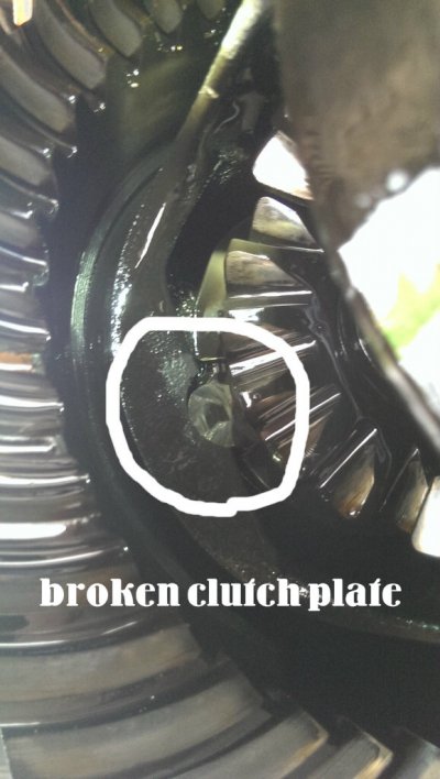

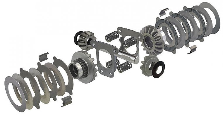

IMO they are better than the clutch style LSD, like what I had in my 01' Off-Road editiona56b7586d139c74127049f7f01d7f14c.jpg65356c1e0c162a35e4e8be8ea379e03d.jpg
