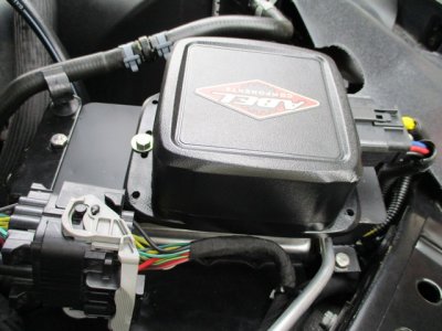

Nice video. Thanks. I had one question. I'm in the process of installing mine now and I'm having a devil of a time getting that control box attached to the fender rail. How did you do that? I really don't want to pull the airbox, but I guess I may have to. Thanks for any help you could offer.

If you are asking about the Abel Component, I didn’t mount with the screws. Just took two heavy zip ties and “suspended” it between the air box frame mount. Right now it’s just tucked in between the rail and air box because I had to cut the zips to adjust the boxes sensitivity. But, think you will need to drill some tap holes first and probably hand screw. With the tools I have, that’s what I would need to do.

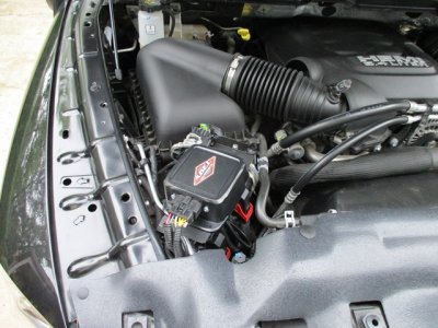

Thanks. I got mine installed this afternoon. I made a bracket over the front fender to hold the box. Back in the fender well is just too hard to get to. It should be dry enough here. I did have a glitch though. I started my truck after the install and it started REALLY slowly (the starter was real slow). Then I noticed that the backup camera and other things on the U-connect screen were gone!! I turned it off, waited, and started again. Everything was fine on this and subsequent starts. I had the negative terminal disconnected during the install. Oh, it also beeped several times when I shut it off that first time. Did I break something? IMG_0758.JPG IMG_0759.JPG IMG_0760.JPG

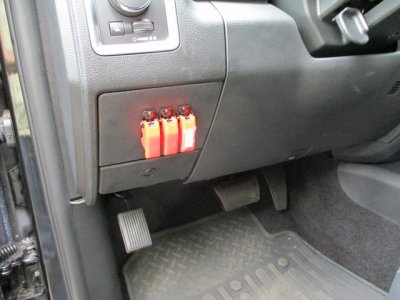

I just installed the nanny kill switch and locker bypass switch (I still have to label the switches). I've already tested the locker bypass, but I'm curious to see how driving with the nanny safeties disabled will be.
