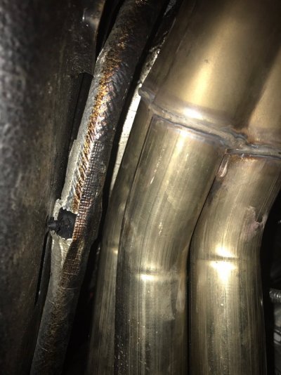

Thanks that helped .... Check this out ... I think I'm good. What do u think ?? I wish they came ceramic coated I wasn't willing to go thru the hassle of having to send en and have em done 229e27c82e34571d998a4dce9285638c.jpg

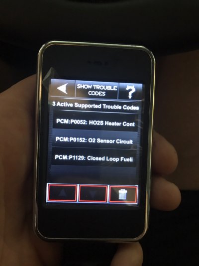

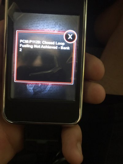

Ok just had headers installed yesterday... Making a log for Sean and my Hemifever ... Threw these codes literally after doing a 0-60 run twice.... 7d478d93f6ab88e328cdaf6f971ed0f8.jpge2a602257b3d6dc2e9e99365cca6d0e5.jpgd08629c3d9035d658656756998b822b0.jpgc634699334f3ebf9009733d652a5e6bc.jpg Anyoje else experience this????

Circuit codes generally mean you have a wiring issue with the rear sensors. I would make sure they are plugged in properly and that he wires didnt get pinched or pulled out of the connectors.
That part is fine as it already has some factory shielding on it. If you follow that heat sleeve towards the back of the truck about a foot or two from where you took that pic you will see the black plastic line bracket with the two unprotected black brake lines sitting close to the Y pipe. That is the part where there needs to be some shielding if sitting close to the Y.

Has far has the codes go it looks like some sort of wiring issue with the O2 sensors like Hemi450 stated. Check the connectors and make sure they are plugged in all the way or you could have even received a faulty O2 extender harness from ARH. Either way it is probably a simple fix.

There are two plugs on the passenger side that are right next to each other ... One black and one white... Wondering if they could have got those to switched up and plugged into the wrong plug. I wonder if I switch them if I'd risk messing something up???

May have figured it out! Checked the o2 sensors numbers and locations with the ones from dealership , one was out of place along with one of them being a wrong number??? (Keep in mind they were my stock o2 sensors) anyways cleared codes and moved sensors , and ensured all wiring and connectors were good... So far no code.... Drove probably 20 hard miles so far.
So learn from my installers mistakes.... Don't mix up the o2 sensors when swappjng from stock to longtubes. !!! Fingers crossed it was a simple fix
