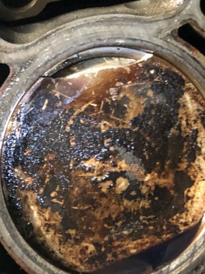

Look what I found

Ouch!! How scarred is the cylinder bore?

Was pulling the heads off to do the cam and look what I found
One of the down sides to adding boost to a stock piston'd Hemi with-out opening up the top ring gap on the stock pistons.Time to put a forged bottem end in it now. You're credit card is gonna be smoking hot,lol
If you're hurting for money,you might get away with dropping 1 new stock piston back in,but you'd want to regap all the rings at the same time.There have been a couple guys who've broke a stock piston and got away with just replacing that 1 piston,but it's what i'd call a temporary band-aid fix till you can afford better pistons,but they've also pulled the blower at the same time.

I dont know what should be my next move. I already bought a cam for the 5.7.
Should I get a forged 5.7 and run the cam I got?
Go 392 route and still use that cam I got for the 5.7
Or go forged 5.7 with the cam and turn boost up to 10 psi?

Yes sir I was boosted when i found out. I raced it a local track last week and it did great. Started pulling the heads off to start the cam swap and I saw it. I was getting ready to put a custom grind boost cam from Jay.

Engine is almost out now.

Cool. Now you can be like me with a semi failed boosted stock engine (had gasket) and getting forged internals.
