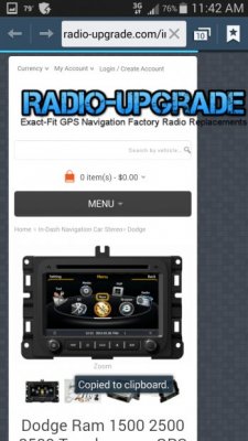

Following along as well. Also bought a 2014 1500 has the 3.0 std. Unit looking to upgrade as well. I jave been looking hard at "radio-upgrade" .com have a very nice touch sreen with gps that is a direct plig and play and looks factory. Not sure about back up camera for that unit but on my truck it is alread installed in the rear view mirror!
hotrodderscott
May 4, 2014
150
17
This is unit im looking at. Not a lot of review. Some one on her said the owner of that particular web site might not be the best to do business with but I have found same unit on several other sites, some even a little cheap.

I'm also looking at upgrading from the 3.0. I was looking at that same unit and found that the only posting on forums were from the seller. That alone makes me suspicious of the quality and what kind of support I would get after purchase. There really aren't any user reviews.

That's a great find! .... Be awesome to find some real world review about it...
That guy came on here pretending to have nothing to do with the company and raved about how great the stereo unit was. He made some careless mistakes though and it was pretty easy to call him out and prove otherwise, which is what happened. Eventually he came clean and admitted he was associated with the company. It was pretty funny stuff. I wouldn't trust any reviews on that radio. They are probably all bogus.
