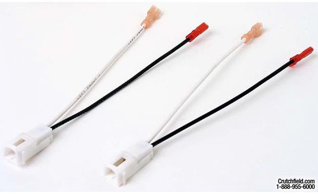

Hey Michael im a auto tech not a audio tech where would i install the resistors and its funny you recommended the jbl's cause i was looking at them what would happen if i didnt install the resistors or bass blockers

When I installed my dash speakers I used a harness adapter to connect the speakers to the OEM harness without having to cut up the harness. I took the adapter, cut one of the two wires, and then soldered the resistor into the adapter to reconnect the cut wire together. I then installed the adapter to the harness and speaker. This is what the harness adapters look like. x12071039-f.jpg

Does it matter which wire to cut in to what would happen if i didnt use any resistor

Either wire would work. It would sound a little brite. The highs would over power the rest and it would be annoying to listen to. You can try it without the resisters and see what I mean. Its not hard to install and then uninstall the dash speaker when using the adapter. I believe you would be happier with the resister inline. But you can hook it up without just so you will know what it sounds like without it.
