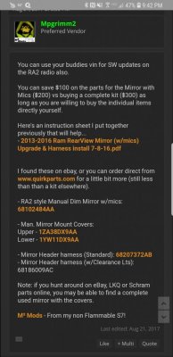

I just got a 2014 ram. I am looking to upgrade my ra1 radio with a ra2. I have the factory back up camera in my rearview mirror. I have seen a bunch of different threads. Just wondering if anyone has a pdf or detailed instructions on how to do this. I got really confused when going through several treads I am looking at getting the radio steering wheel and mirror from a 14 2500 at a local parts place. Wills these work? Any advice/help is appreciated.

Im curious too...Also just bought a 14, same backup camera in the mirror also added ra2. looking to get info on wiring the camera from the mirror to the ra2.

I have read from the forums on here there is a vendor on here m2 mods that sell the harness for around $50 to switch the camera from the mirror to the ra2 radio.
